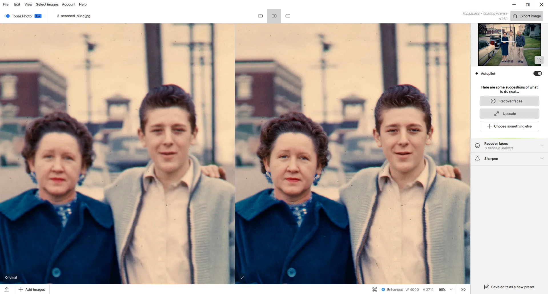

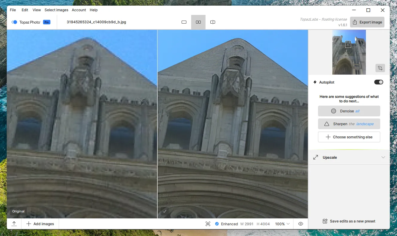

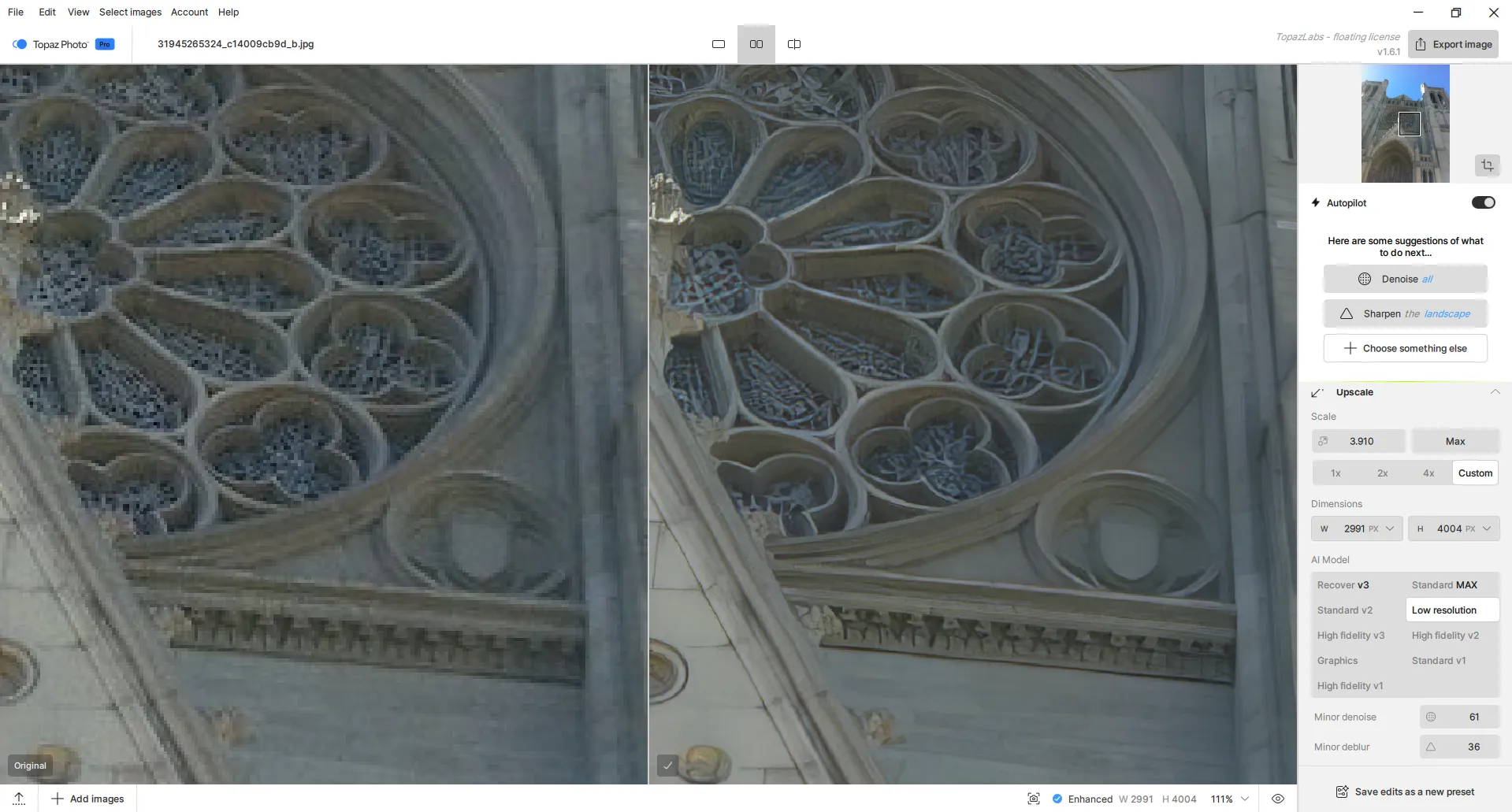

Topaz Photo AI
Topaz Photo AI is the app that comes up most often in YouTube reviews and articles about fixing pixelation and other digital photo defects. I decided to start my search with it.
The developers put a huge amount of effort into automating the restoration process. As a result, Topaz Photo's interface is minimalist and barely has any switches or settings. When you add a photo, the app automatically figures out the context of the composition and launches the appropriate AI tools. The neural network recognizes objects in the shot: faces, skin texture, fur, architecture, vegetation, and text.
The algorithm doesn't just stretch pixels — it literally "fills in" lost details and edges, drawing on a dataset of millions of processed high-resolution photos. If you're not happy with the result, you can fine-tune the main parameters or choose a different model.
That said, when you pick a model, it first has to be fully downloaded to your computer before it can be applied. During my tests, for example, Topaz Photo AI used up about 50 GB of free disk space.
It's also important that all the pixelation fixing runs on a discrete graphics card — otherwise, processing time can stretch into tens of minutes. Even so, Topaz Photo AI delivers high-quality results.
It's worth specifically calling out how it handles people's faces. The face detection and restoration feature works effectively, carefully bringing back sharpness to facial features and skin texture without creating that "plastic mask" effect.
Pros of Topaz Photo AI for fixing pixelated photos
Automation and smart analysis.
High-quality face restoration.
Deep detail reconstruction.
Cons of Topaz Photo AI for fixing pixelated photos
High demands on free disk space.
Dependent on GPU power.
Sold on a monthly subscription basis (from $17/month).

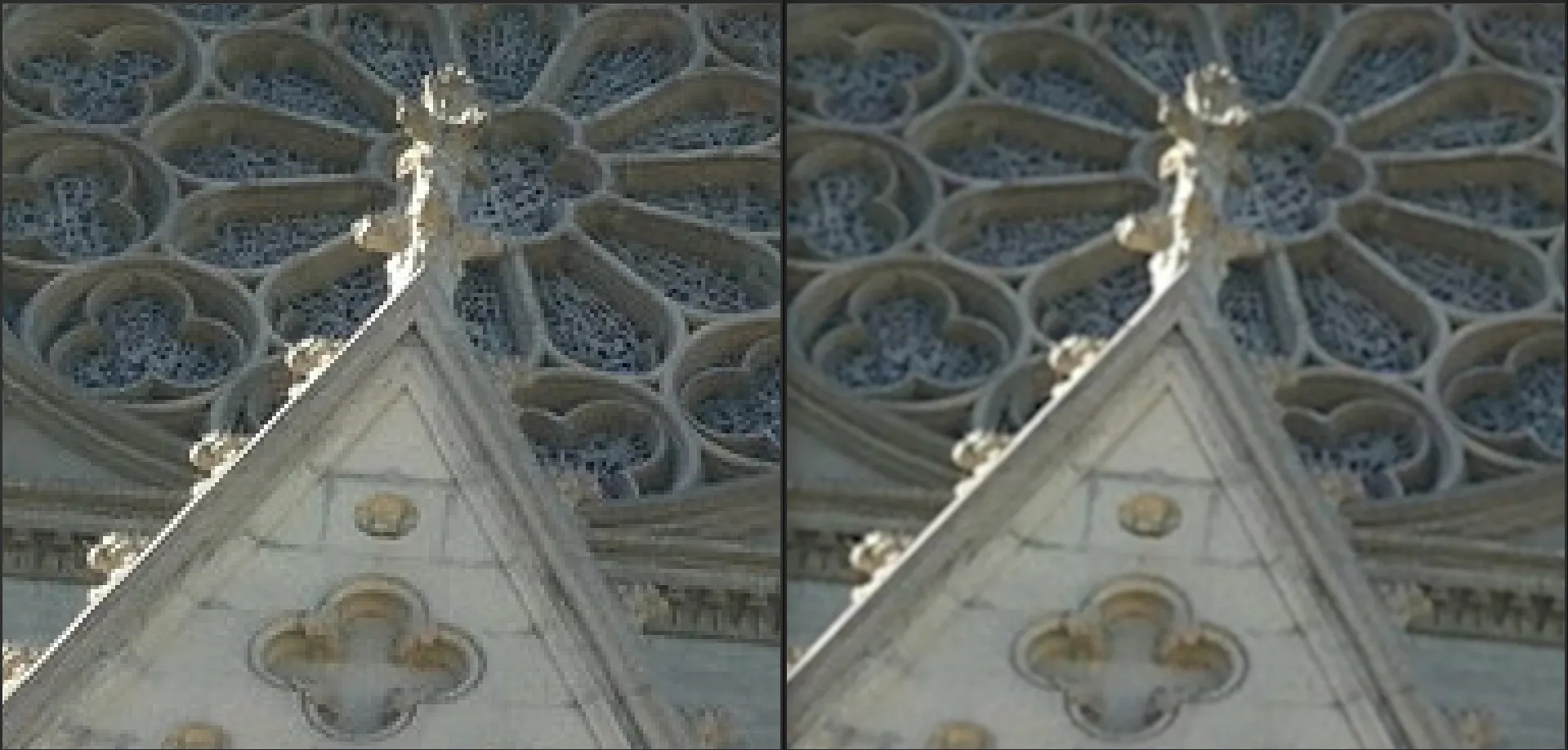

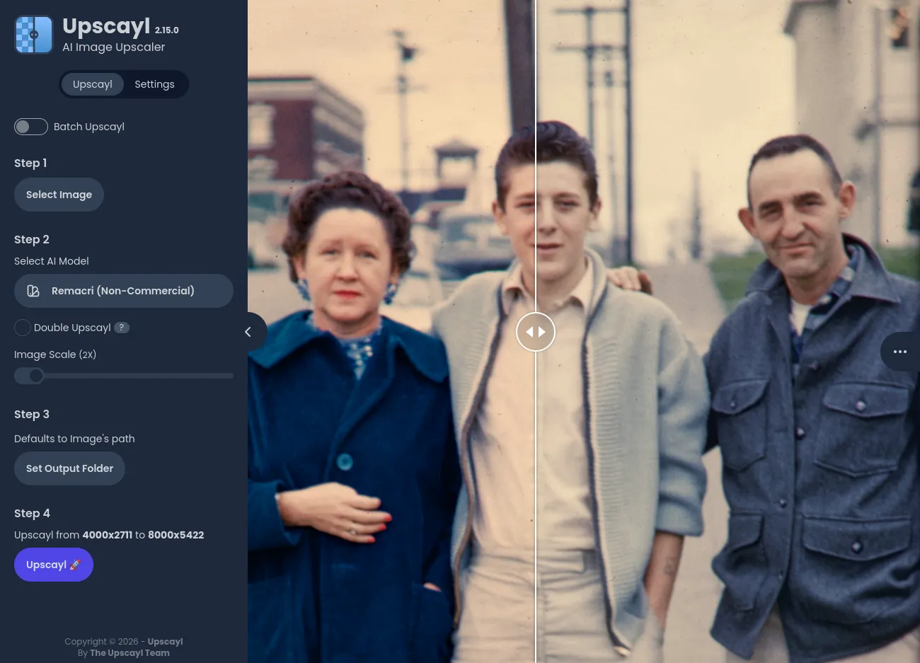

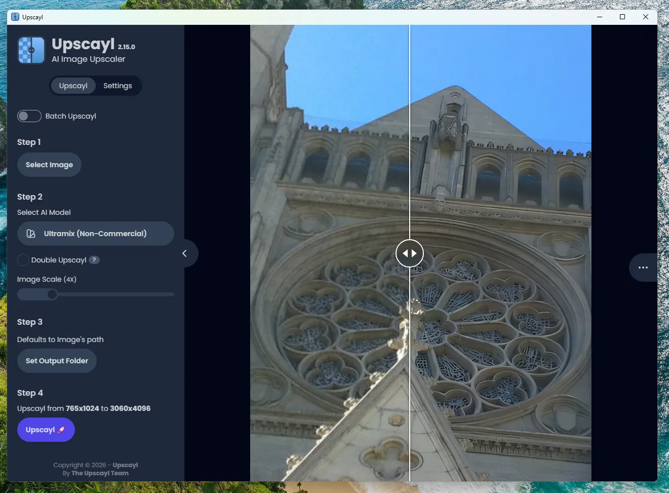

Upscayl
Since Topaz Photo AI is demanding on computer resources, and processing itself takes around 5 minutes per photo (and I had several dozen), I had to look for a lighter alternative. So I decided to try Upscayl.
It's a free, open-source app built on the basic, publicly available GFPGAN/Real-ESRGAN models.
The app handles JPEG compression artifacts and visual pixelation well, making edges smooth and crisp. However, Upscayl doesn't fix out-of-focus or blurry shots. If the original frame isn't in focus, you end up with a larger but still blurry image.
Overall, Upscayl works well if you need to fix pixelation on landscape shots or photos of building architecture. For shots featuring people, you're better off with Topaz Photo AI or looking for another alternative.
Pros of Upscayl for fixing pixelated photos
100% free with no ads.
Photos are processed on your own PC and never sent to remote servers.
Cross-platform.
Simple interface.
Cons of Upscayl for fixing pixelated photos
Demanding on hardware.
Very few manual settings.
Low effectiveness of the free models.
Slow development — no updates in two years.

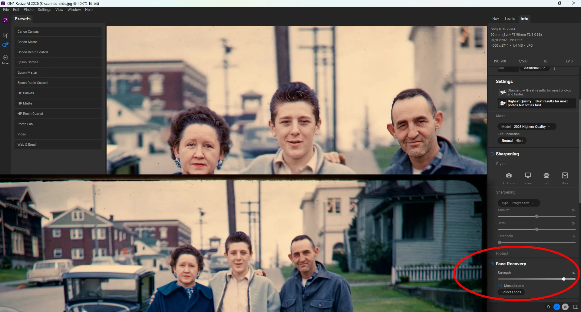

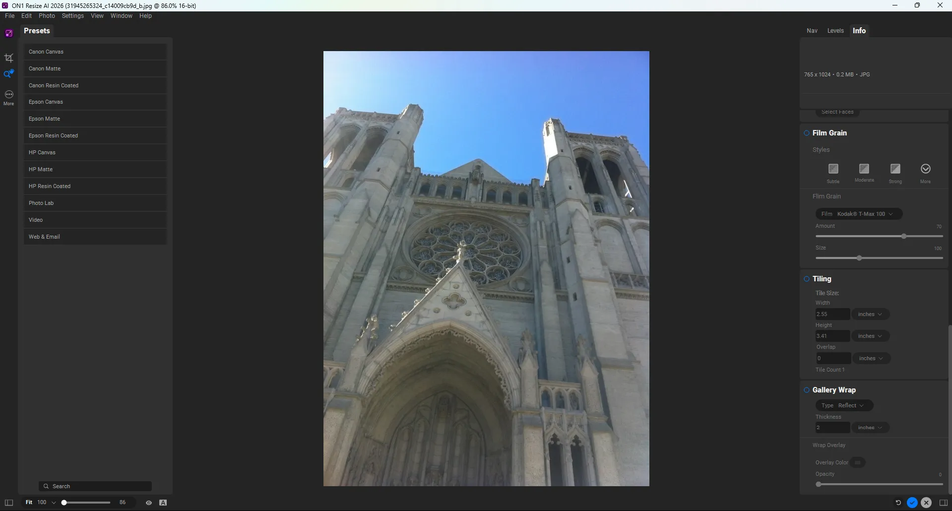

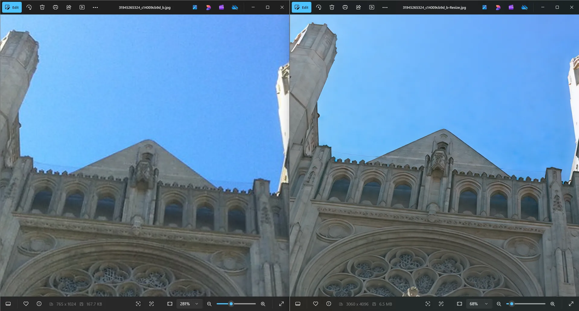

ON1 Resize AI
ON1 Resize AI caught my interest because it uses the Genuine Fractals system, whose roots go back to the late 1990s. It combines classic fractal algorithms with modern deep-learning neural networks and diffusion-based super-resolution models. I don't know much about the inner workings of AI models, but even the names alone inspire confidence.
ON1 Resize AI's interface resembles Topaz Photo's but feels more advanced, mainly because of its deeper manual controls. Here you can fine-tune the pixelation-fixing process and add filters or adjust effects.
Even without precise adjustments, though, the app produces a fairly solid result.
I liked how the face restoration model works here. It finds portraits in low-detail or pixelated shots and restores natural facial features, eyes, and skin structure using an adjustable strength slider. There's a slider that lets you control the intensity of the algorithm's effect in real time.
Pros of ON1 Resize AI for fixing pixelated photos
High quality of edge preservation after processing.
Professional print-preparation tools included.
Works with both RAW and JPEG.
Flexible control over how strongly the models affect the final result.
Cons of ON1 Resize AI for fixing pixelated photos
Neural network processing and diffusion models require a powerful graphics card.
If the source is extremely compressed or pixelated, the AI can produce overly smooth, "painted" textures.
A lifetime license, but at a price too high ($119.99 before any discount) for what's essentially a single module.

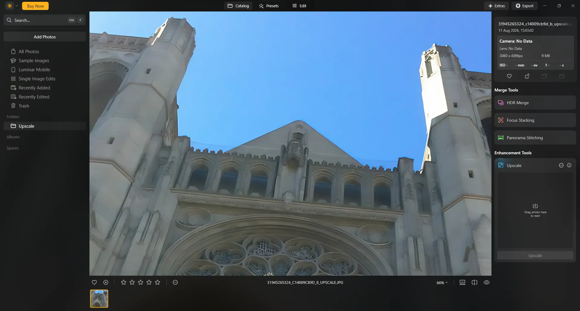

Luminar Neo
Unlike the previous programs, Luminar Neo is a hybrid photo editor that combines classic photo editing with AI extensions. It's a full-fledged competitor to Lightroom when it comes to "developing digital negatives." The app offers a huge range of editing tools, but when it comes to fixing photo pixelation specifically, it performs only mediocrely.
Even without comparing it to the original, you can see the built-in model tries too hard. The result comes out looking overly "plasticky," with none of the natural imperfections left.
Pros of Luminar Neo for fixing pixelated photos
Easy to use.
A comprehensive, all-in-one approach.
Batch processing.
Cons of Luminar Neo for fixing pixelated photos
A "watercolor/plastic" effect after processing.
No tools to reduce how strongly the AI model affects the image.
First and foremost an editor for professional photographers, not a tool for improving old photos.

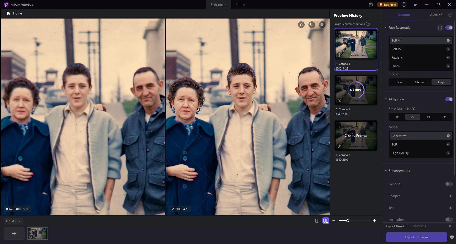

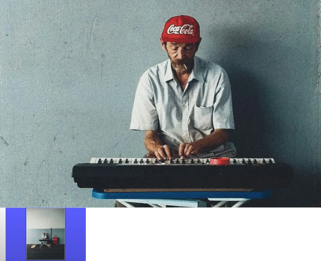

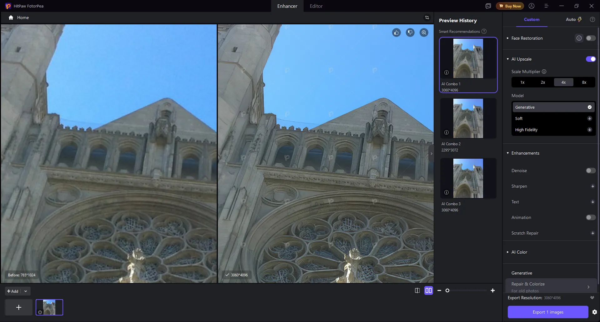

HitPaw FotorPea
As it turns out, HitPaw FotorPea is one of the few programs originally built specifically for AI-based photo enhancement. And it's not just an upscaler — it's a multifunctional solution that bundles together several models at once. It includes tools for increasing resolution, removing noise, restoring faces, fixing blur, working with text, and restoring old photos.
Despite the extensive feature set, I didn't have to figure out dozens of technical parameters. You just add a photo, and then either use the automatic mode or pick a processing model yourself.
To fix pixelation, I used the AI Upscale model. It increases the image resolution while trying to restore small details lost during downscaling or compression. It also offers three processing variants at once, letting you pick the best one.
In my view, the ability to choose a specialized model is one of FotorPea's biggest strengths. For portraits, for example, there are several Face Restoration options: Soft V1, Soft V2, Realistic, and Sharp. Realistic is meant, among other things, for very low-quality or partially obscured faces, while Sharp emphasizes edges and facial contours. You can also adjust the strength for the Face Model.
This helps you avoid situations where the neural network "over-improves" a face and turns skin into a smooth plastic surface. That said, it's impossible to fully rule out that effect. At maximum processing strength, the app can still start adding too many invented details.
Pros of HitPaw FotorPea for fixing pixelated photos
Several specialized AI models for different types of defects.
Good quality when increasing photo resolution.
Effective face restoration with adjustable strength.
Separate models available for noise, blur, and JPEG artifacts.
Specialized text processing.
Ability to upscale images 6× and 8×.
Tools for restoring old and damaged photos.
Scratch removal and colorization.
Automatic selection of the appropriate model.
Cons of HitPaw FotorPea for fixing pixelated photos
Under heavy pixelation, the AI starts inventing details that weren't in the original.
Faces sometimes come out too smoothed or different from the original.
Some models create artificial-looking textures when upscaling too aggressively.
Needs solid hardware for comfortable use.

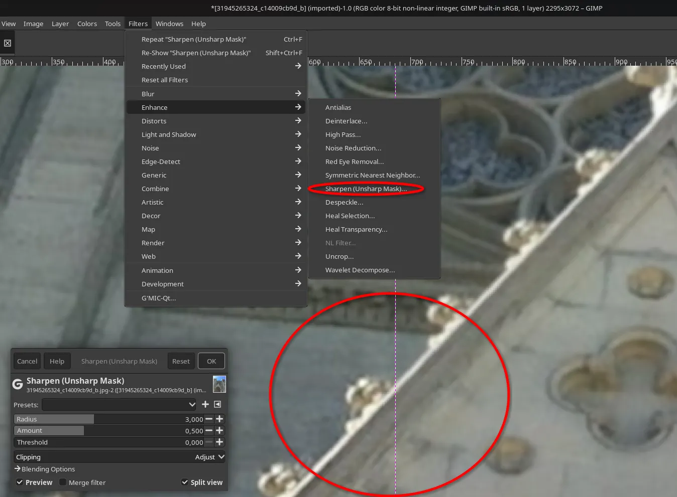

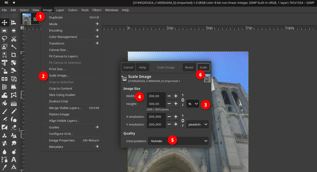

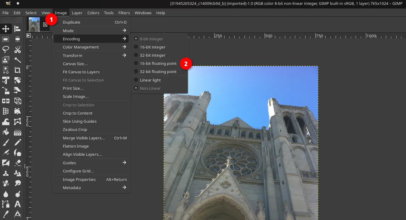

Fixing Pixelation with the GIMP Image Editor
The downside of every AI-based tool is that it distorts accuracy. They can invent elements that don't actually exist or warp proportions. While that's not critical for landscape shots, it's unacceptable when dealing with historical buildings. For fixing pixelation on photos like that, I used the GIMP image editor.
First, I changed the image encoding from 8-bit to 16-bit floating point. This doesn't affect the encoding of the final result, but it does expand the available color range while you're editing.
The next step is increasing the image's resolution. When you do this, it's important to choose NoHalo or LoHalo in the interpolation dropdown. These modern algorithms, part of GIMP's GEGL engine, are specifically designed to resize images without creating sharp, high-contrast color halos around pixels. For convenience, I set the size in percentages.

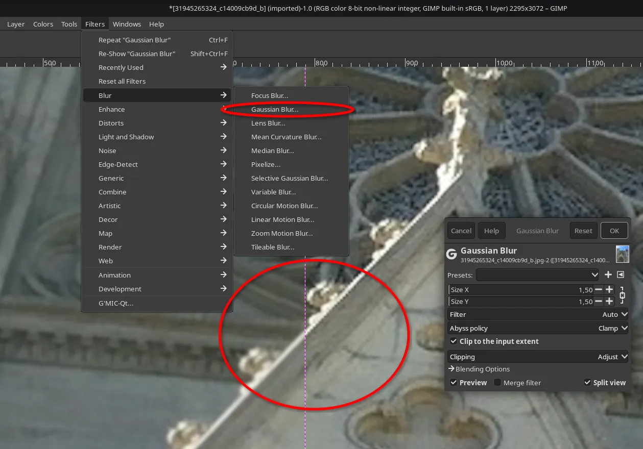

To get rid of the stair-stepped pixel squares that stand out especially on high-contrast edges, I use the "Gaussian Blur" filter.
To bring back edge sharpness, I use the "Unsharp Mask" filter. This emphasizes silhouettes and details in the frame, restoring crispness after the smoothing step.

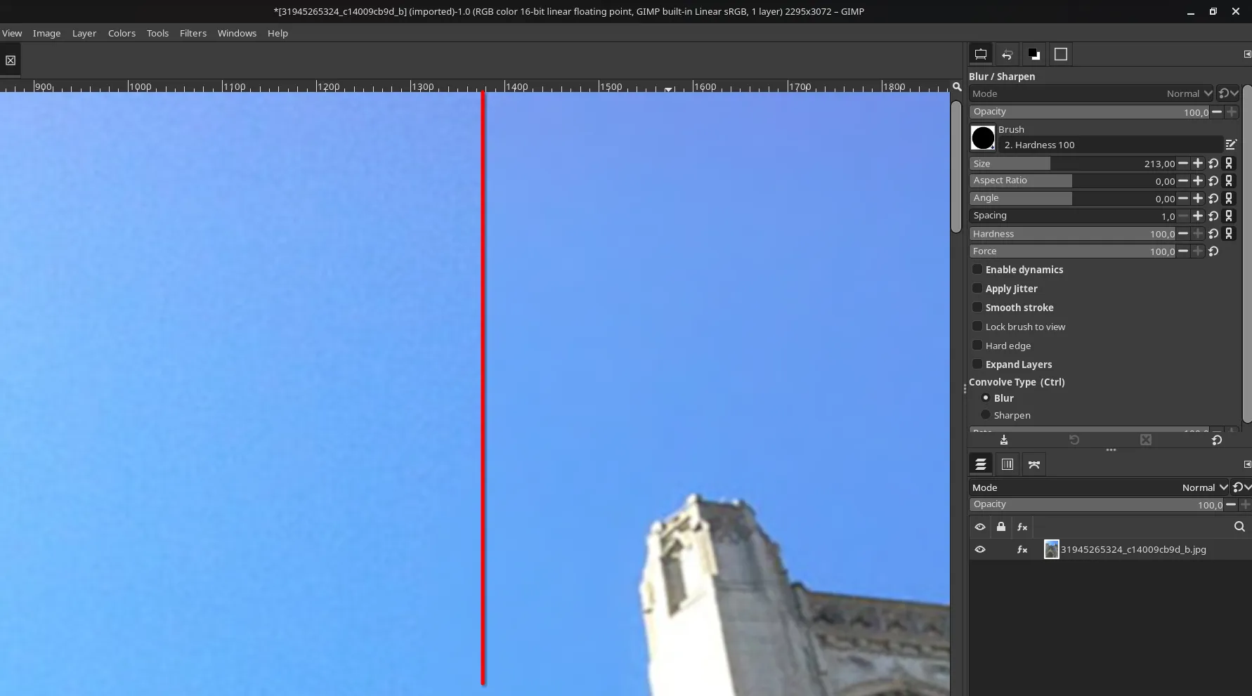

The Blur/Sharpen tool is great for fixing pixelation over large areas of a photo. In this particular example, I used it to restore the sky.
The result of fixing pixelation using this simple technique in GIMP.

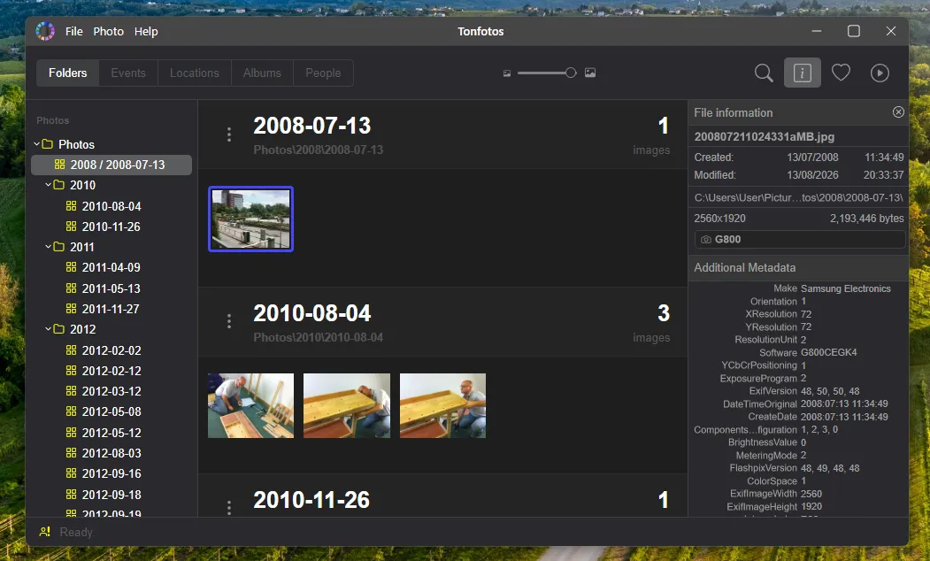

Sorting Pixelated Photos in a Home Photo Archive
While looking for a tool to fix pixelation, I discovered that finding all the old photos scattered across thousands of files in different folders on my computer was actually the hardest part. Manually opening every shot, checking its quality, and moving it to a separate folder for further processing seemed like a completely unrealistic task. So I started looking for a solution, with simplicity, versatility, and price as my main criteria.
As it turned out, far from every available program meets these simple criteria — probably because developers try hard to grab customers' attention and end up building in features that aren't always relevant to a given product.

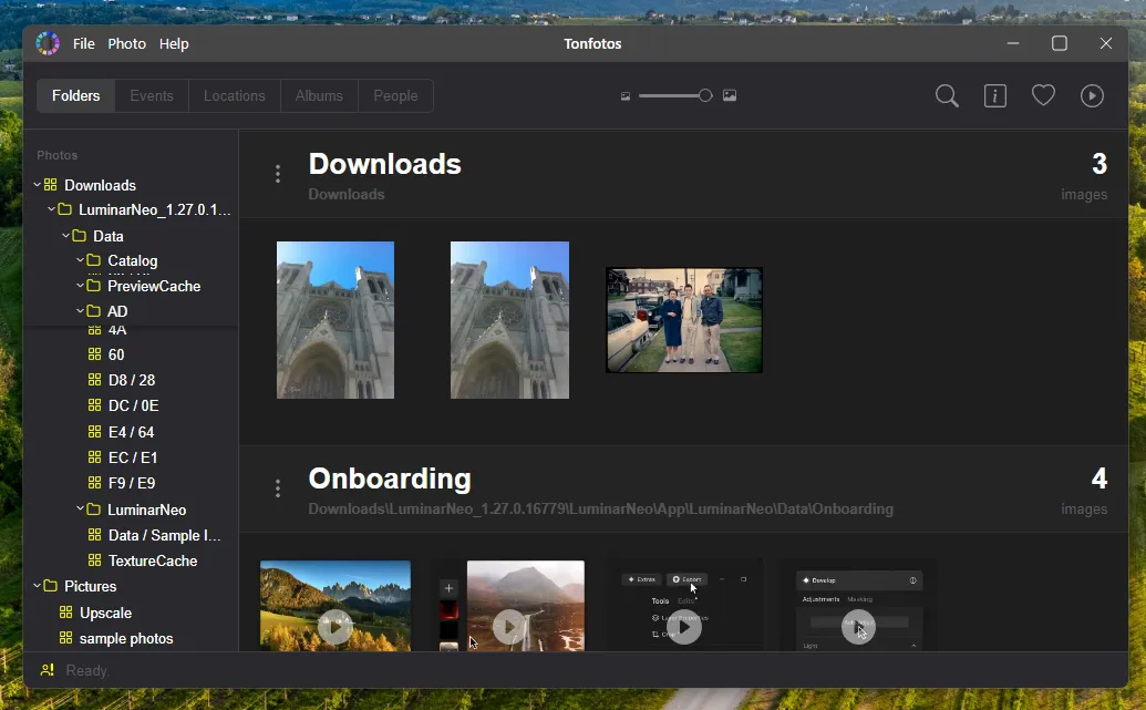

Among the whole range of photo managers, Tonfotos caught my attention. At first the app seemed too simple, but after a closer look and some testing, it turned out to cover everything I needed for finding pixelated photos.

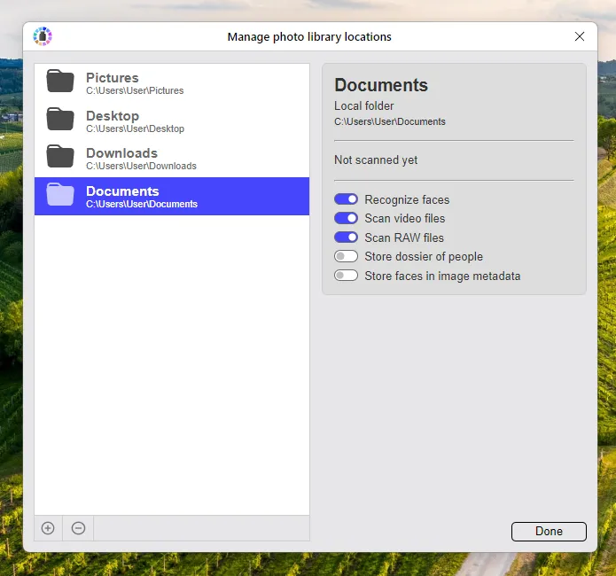

Organizing a single photo archive

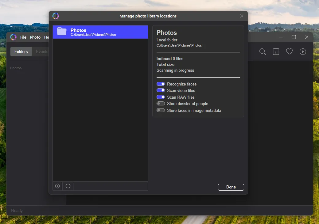

On first launch, I decided to trust Tonfotos's recommendations and added several photo sources right away. As it turned out at the next stage, that was a mistake.
The program simply gathered all the folders into a single interface, keeping their original names — names that were often meaningless, created with a "I'll rename it later" mindset, or turned out to be system files belonging to other programs.

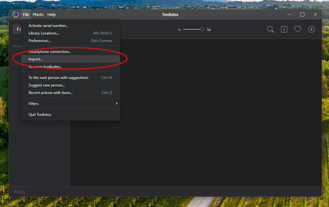

That didn't sit well with me, so I took a different approach. First, I removed all the added folders (removing sources in Tonfotos doesn't touch the actual files on disk), then I created an empty folder, which became the foundation of my photo archive.
After that, I used the import feature.
What's convenient about it is that it doesn't just copy photos into a specified folder — it builds a clear, hierarchical folder structure based on the metadata of when each photo was taken.
I should note that however the folders appear in Tonfotos is exactly how they're structured on disk as well. To confirm this, just open the photo archive folder through File Explorer.

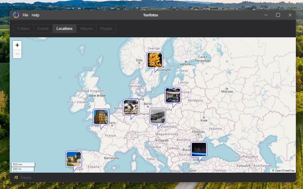

Navigating and finding pixelated photos in Tonfotos
At this point I could have stopped and just started fixing pixelation photo by photo, opening each folder in turn. But Tonfotos can simplify this even further. For instance, the "Places" section shows all shots with a saved geolocation tag on an interactive map.
As a result, if you want to see all the photos from a 2008 vacation, you don't need to remember the exact date — you just navigate to the right location and browse everything taken there.

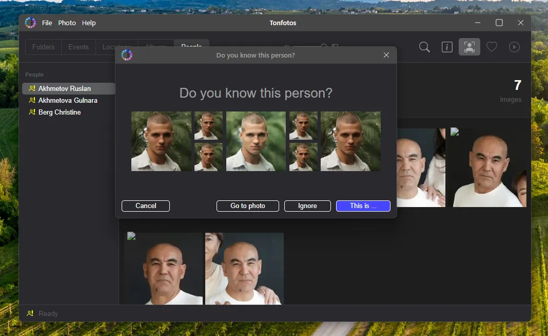

If you need to find every photo of a specific person, Tonfotos has a built-in algorithm for detecting and recognizing faces in images. Just tag someone's name once, and the program will automatically find every shot featuring that person.
Tonfotos turned out to be more than just a photo manager for me — it became a handy tool for the initial task of sorting out shots that needed restoration. I ended up with a single photo archive where I can quickly find the shots I need by date, location, or person. Of course, Tonfotos doesn't flag pixelation as a specific defect, but at the stage of searching for and sorting old photos, it noticeably simplifies the work.
