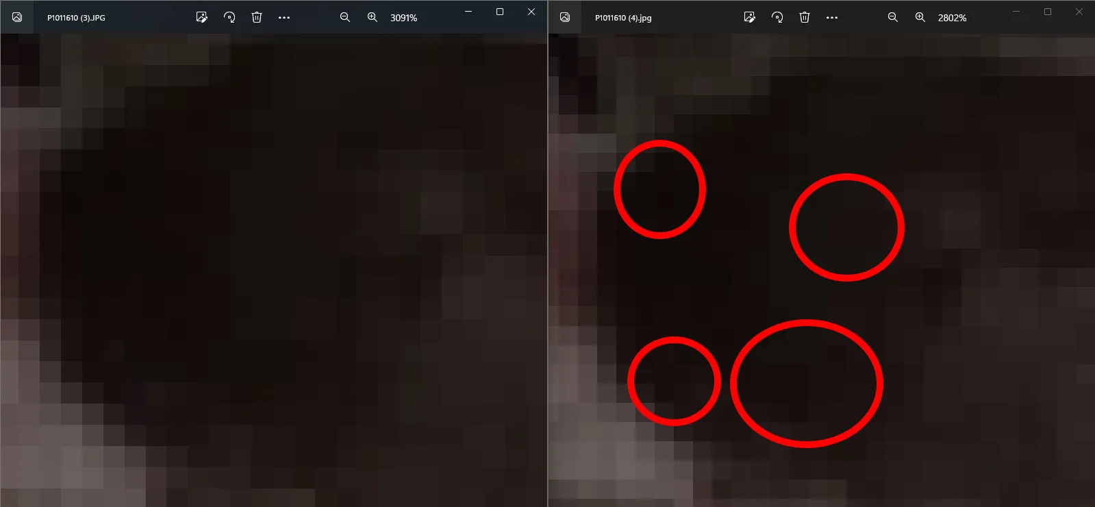

The disadvantage of this method, in addition to a fairly large number of actions that need to be done, is a decreased quality of an image. The fact is that JPEG (like many other popular photo storage formats) is a lossy compression algorithm. To keep the file size small, it gets rid of some of the "less significant" details in the image. Accordingly, when you have changed the image in the editor, you save it again in this format, throwing out the next portion of “extra details”. For clarity, let's enlarge a certain section of the photo before and after changing the orientation in the graphics editor.

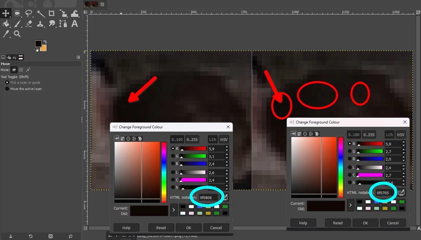

Below on the left you can see an image of the original photo, and an image- after a pixel-by-pixel rotation change in the GIMP program - on the right.
Here, you can see with the naked eye that individual pixels have a distorted tint, which is further confirmed by the Eyedropper tool.
Photoshop 2024 showed a similar result, only with less color distortion. Similarly: “before” on the left and “after” on the right.

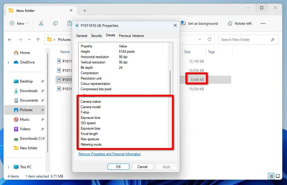

It is noteworthy that the image file size increased after changing the photo rotation in GIMP, but decreased relative to the original value after Photoshop 2024.
This may be due to the image compression settings in Photoshop. In addition, all metadata were deleted.

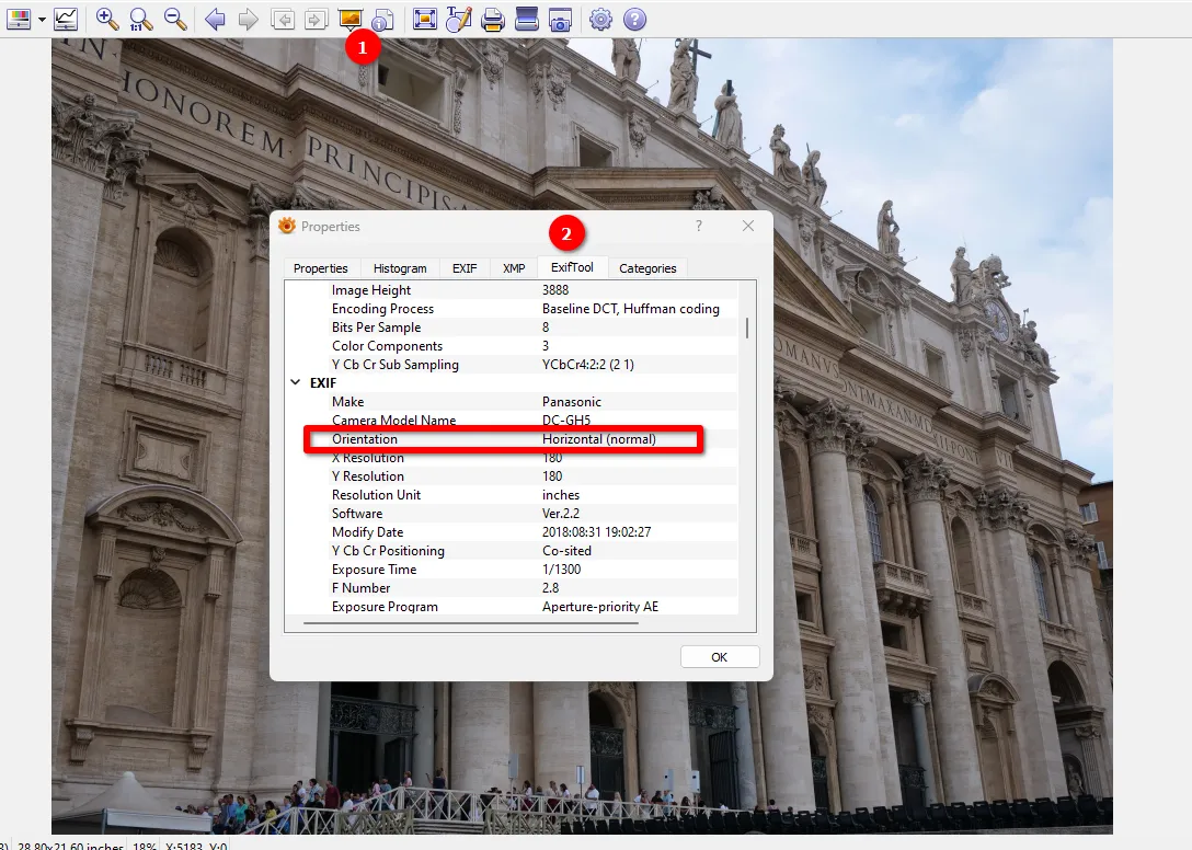

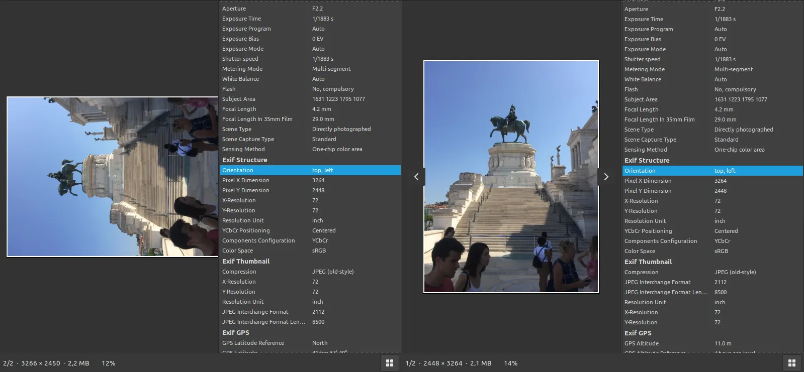

Metadata is stored inside the raster image file and contains information about when, where and how the photo was taken, and the name of the device. There are different metadata standards (EXIF, IPTC, XMP), each has its own purpose. However, in the topic of this article we are interested in EXIF, because there is an Orientation tag in this metadata, which tells the viewer how to display the image or photograph correctly.
A distinctive feature of this photo processing method is that the image file does not actually change its orientation in the device's memory. Metadata only gives instructions on how the image itself should be displayed.

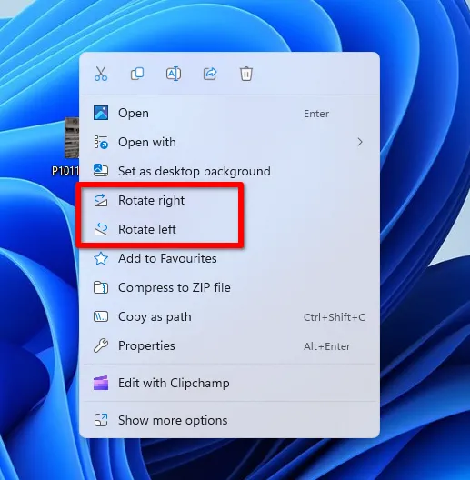

The Windows 11 operating system compares favorably with previous releases in a way that its standard tools have good integration with image metadata. For example, to change the rotation of one or more photos, just select the necessary files, call the context menu and select the appropriate rotation option.
A similar function is provided in the pre-installed Photos application, which is included in Windows 10 as well. However, you can only change the orientation of a photo in one direction, so you will often need to press the button several times to get the desired result.

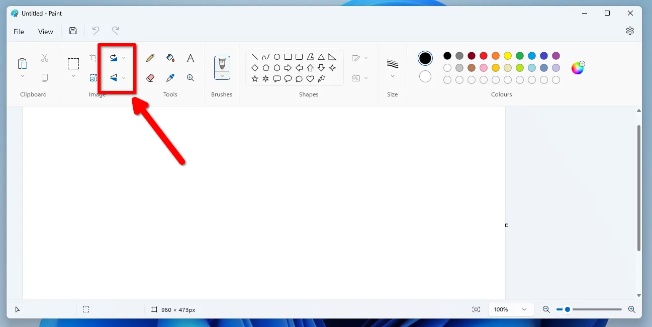

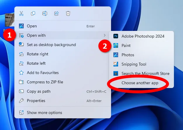

You can also rotate a photo in Windows 10 and 11 using the pre-installed graphics editor “Paint”. Select the required photo and call the context menu. Next, go to the “Open with” item and click on the “Paint” button. If it is not in the list, you should click on “Choose another app” and select this application from the full list of installed editors.
All that is required to rotate a photo through “Paint” is to select the corresponding icon in the top main menu of the program.
In all the methods described above, the position change is carried out precisely through the EXIF metadata, which can be verified by opening the photos in the XnView program.

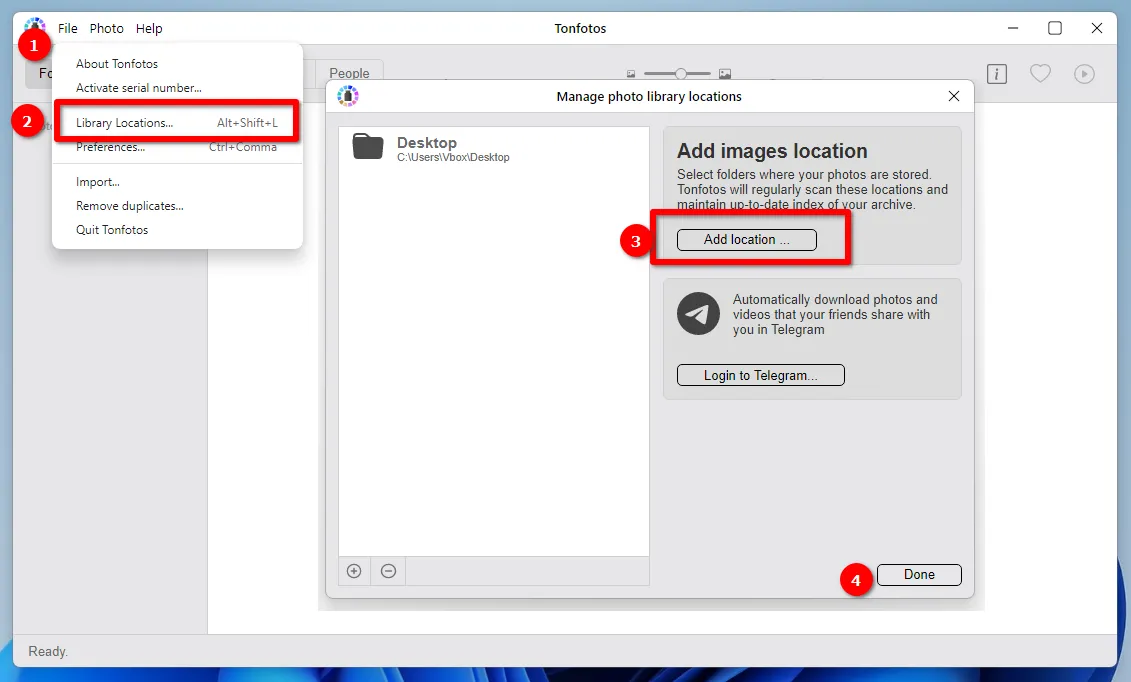

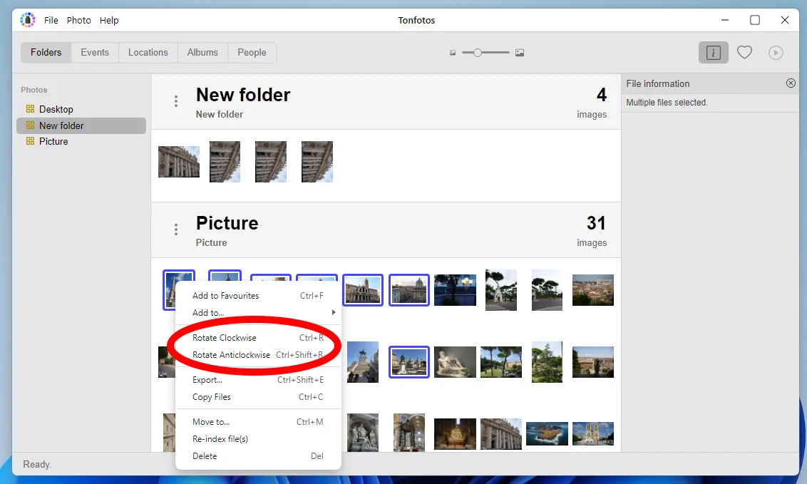

The solution to this problem is a third-party program Tonfotos, which can be downloaded for free. This is a convenient cataloger with metadata editing functions. To start working with images, you must first add the folders where the photos are located to the program and wait until they are indexed.
Next, you need to select the necessary files by holding down the CTRL button on the keyboard, and use the context menu to set the required direction of rotation.
It is worth noting that, as in the case of standard Windows 11 tools, Tonfotos does not degrade the quality of the photo by re-compressing, but only adds the corresponding data into the EXIF metadata tag.

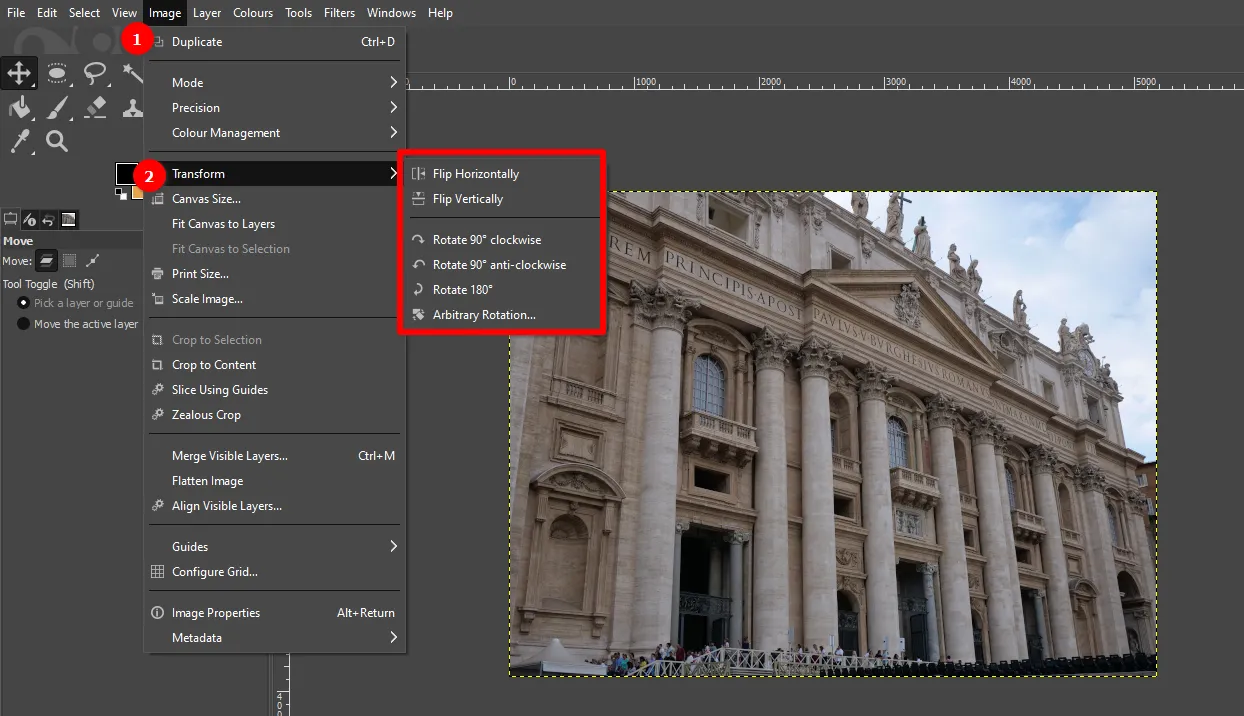

How to rotate a photo pixel by pixel?
If you need a pixel-by-pixel change in the angle of rotation of a photo, use the functions of the graphics editor GIMP or Photoshop.

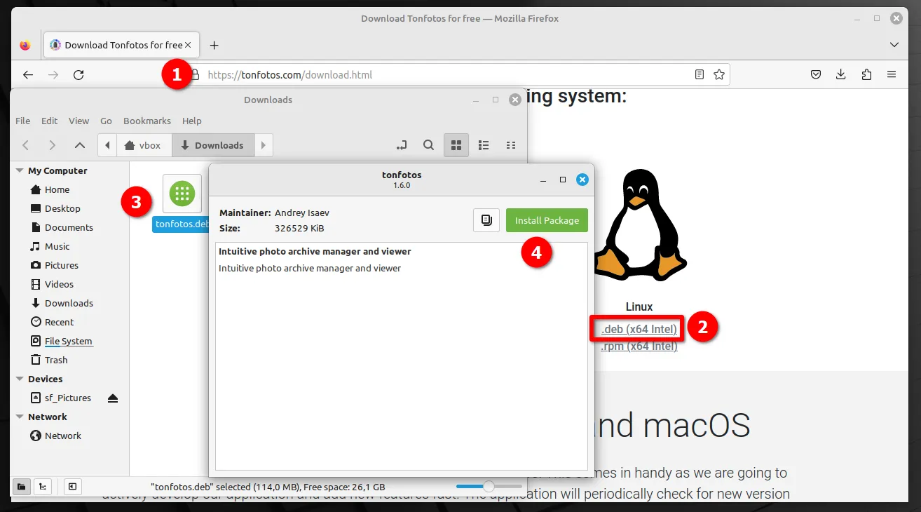

Unfortunately, Linux distributions do not support the ability to install Photoshop due to Adobe's short-sighted policy; only the pre-installed GIMP is available. However, this class of operating system supports Tonfotos, which can rotate photos without degrading their quality.

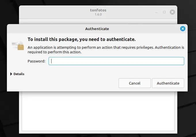

If you are using the Linux Mint distribution, then you can easily install the program. You need to download the DEB package from the official website https://tonfotos.com/ and just run it.
The last step to start the installation process is to enter the administrator password.

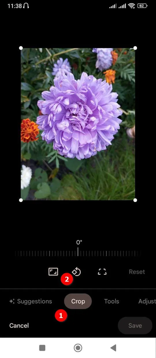

To start editing previously taken photos in the Android operating system, you need to open the Google Photos application, find the desired photo and open it. Now you need to click on the “Edit” button and find the “Crop” function.
Here you can set a more precise angle of rotation of the photo, but that part of the image will be cropped. This is because the image is a matrix of pixels, and when rotated, those pixels that were previously on the edge of the photo are now inside. The program removes these pixels to maintain proportionality.
However, this method of rotating a photo not only resaves it again, losing quality, but also changes it relative to the original photo.

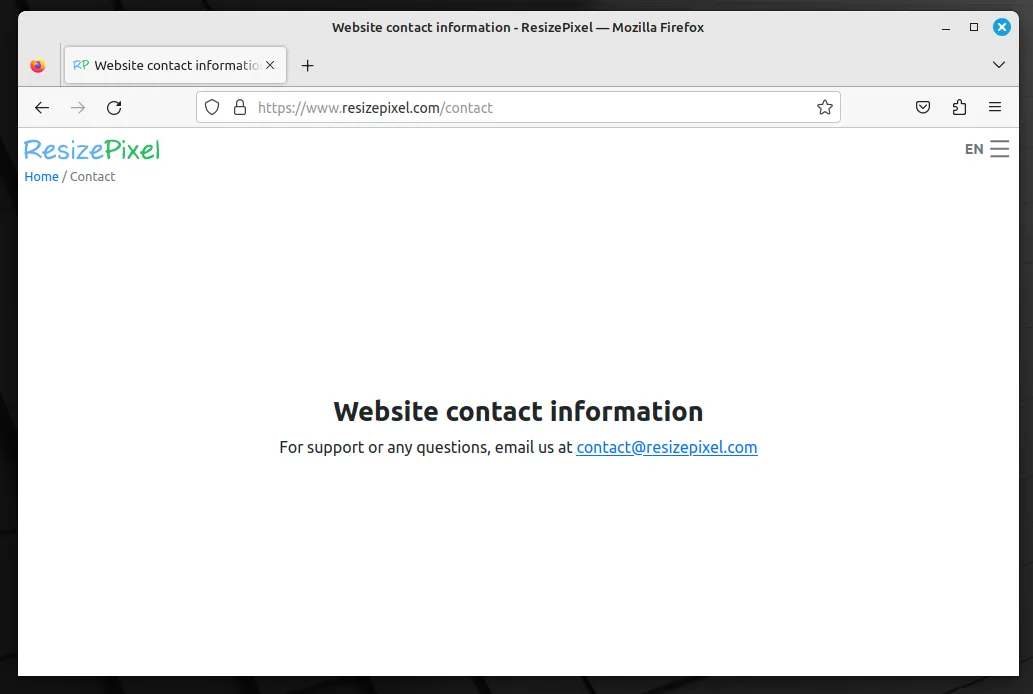

The main problem with such services is that you trust the photo to someone unknown. For example, the privacy policy of resizepixel.com states that the service automatically deletes all images uploaded by users, but it is impossible to verify whether this actually happens.
The company does not provide any other contact information other than an email address.
